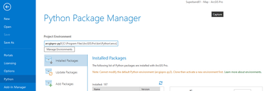

kolkokolko - in ArcGIS Pro->Project tab->Package Manager, what is your Active Environment (top right)?  Is is arcgis pro-py3 or something else?  I'm wondering if you're perhaps working in a cloned enviroment vs the default environment.  (Caveat:  I'm am not a Python developer so working on my view of this ArcGIS Pro environment.)

Hi Robert,
what I could find is the following:
There is only one environment "arcgispro-py3"[its\location\path] attached picture below.

Hi Danail - okay that looks fine.  In reviewing the Tech Support cases, several customers saw a similar error message.  Their resolution was to uninstall and reinstall ArcGIS Pro.  This cleared the issues with the GP tool.  I'd recommend doing this workflow as it would only take about 10 minutes max and serve as a good test to see if it fixes the error.
