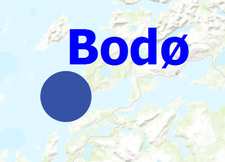

I'm experiencing a problem with the colors when exporting to PDF. The issue was first experienced in an extensive project but now I'm able to reproduce it at will with even the simplest design. When I export a map or a layout to PDF, the color of symbols gets duller. It is very similar to what you'd expect if screwing up the color management in a photo project. So far I've only seen the color change on vector symbols, not their labels, and not on the underlying raster.

Try to determine if the color is the same on the label and the symbol.
To determine the colors above, I pasted a screenshot of Adobe Acrobat into Photoshop and read the RGB.
Both colors were set to RGB (0,0,255)
In photoshop they are read as RGB(0,0,255) and RGB(53,82,165). The change from (0,0,255) to (53,82,165) is very similar to the one seen when converting an image from sRGB to the FOGRA39 (CMYK) color profile.

Thanks for the reply. I have read the page on Exporting Maps without finding a solution. As mentioned in the initial post, I have only experienced this problem with PDF export. I have exported without any map in the background, with raster and with vector maps - the problem still persists. Interestingly enough, even though the vector map was symbolized with a lot of CMYK colors, when i changed inland waters to RGB(0,0,255) it rendered perfectly in the export - but my blue dot did not.

* Setting Simulation profile to U.S. Web Coated (SWOP) v2 - both symbol and text becomes darker RGB(53,82,165)
* Setting Simulation profile to sRGB IEC61966-2.1 - both symbol and text becomes lighter RGB(0,0,255)
When previewing with the Object Inspector I get the following by clicking on the text and symbol.
More testing have revealed that when viewing the pdf in Google Chrome v53.0 and Internet Explorer v11.321 the colors look correct. The pdf also looks correct on iOS v10.0.1 with Adobe Acrobat Reader v16.10.11 and in iBooks.
This looks like some sort of bug, either with Adobe Acrobat or with ArcGis. Either way it looks unnecessary to go via ICCBasedCMYK when nothing in my document is using CMYK.
