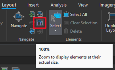

What I am trying to post here is about the Layout in the Pro. If you use the button "Zoom to display elements at their actual size"   Look at the screen :
Ok, so if I use that button to zoom it to 1:1 in the layout,  Does it mean on the map will look the same when you print at the plotter ?
Here is what Zoom to 1:1 looks like in the Layout .

What you see on the Layout view is what you will get when you print or export the layout. However, the 1:1 button has no bearing on this. It just resets your zoom level to 100%

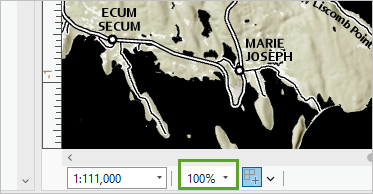

The 1:1 button does not change the scale of your map.  Zoom in and out on the layout and watch the controls in the bottom left corner. You'll see that scale does not change, while the zoom does change. If you click the 1:1 button, scale resets to 100%. Zoom is only for viewing on your computer screen. It has no bearing on printing or exporting.

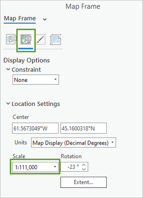

If what you see on the Layout view is not what you want to print, you need to change the scale of the map. You can set the scale of the map frame by double-clicking it in the Contents pane.
This will open the Map Frame pane. On the Display Options tab, you can set the Scale.
