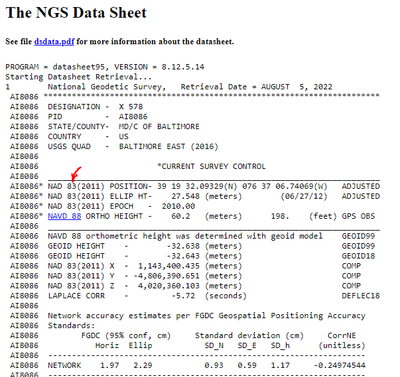

I am looking for the well known ID (WKID) Geographic Coordinate System for this NGS Datasheet NAD 83 (2011) and another NAD 83 (1991):

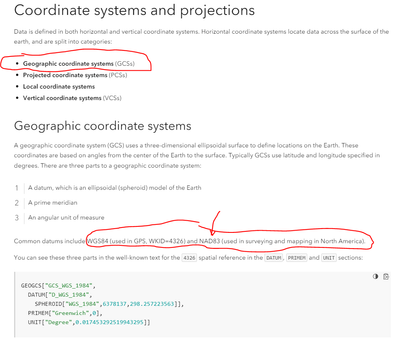

ESRI Recognizes both WGS84 and NAD83 as common datums, however I'm having difficulty tracking down NAD83's WKID.

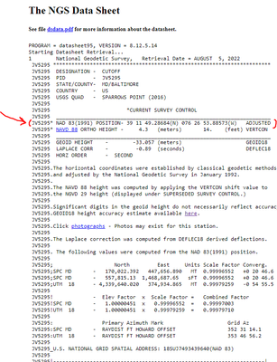

FYI: Here's the NGS data sheet for a NAD 83 (1991) point.
Another way of saying what I'm trying to do is recreate this NGS point as proper Point Geometry from the lat/long NGS data sheet.  So I need the WKID NAD 83 (1991) sometimes, and (2011) sometimes, and other depending on the data sheet.

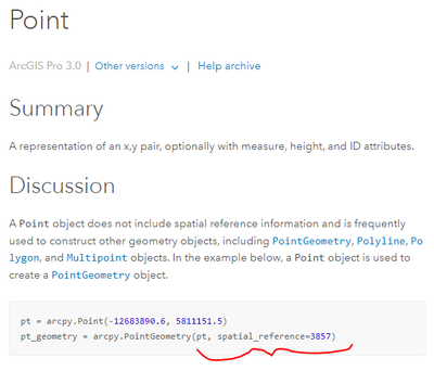

ESRI docs helpfully describe PointGeometry creation:

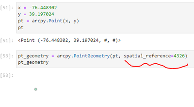

And here is my real world example for the datasheet point above EXCEPT I plugged in 4326 for EXAMPLE only.  What is the spatial_reference (WKID) for NAD 83 (1991)?
(successfully created PointGeometry, just need proper spatial_reference)
HTH better describe the question.  Thank you.
