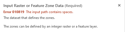

Error 010819 Spaces in Paths:
Using Pro 3.5.1.
When adding source data to a GP tool from within a map (i.e. not from Catalog) this error is shown.
The same data, same workflow in 3.3.x does not have this problem.
Drag & drop the same data from within a FGDB in Catalog does not create the error.

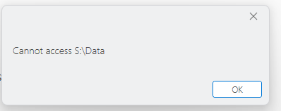

Using Pro 3.5.1.
Create New LAS Dataset cannot access a network share.  This error did not occur in 3.5 as I used it to create las datasets in the same project a week or so ago, before loading 3.5.1
I can create the dataset on a local drive, copy it to the network and use it as usual.
No updates or changes have been made to the file server.

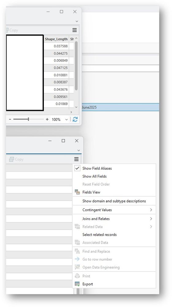

Edited - Context menu (Find and Replace) not showing for editable table:
