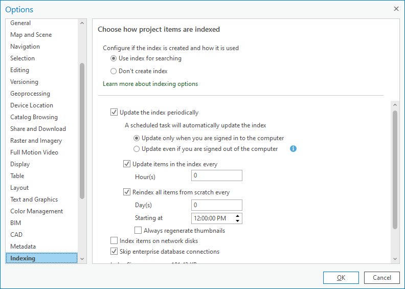

Have you tried disabling indexing? In the past, I've suspected that helped, although it wasn't conclusive.
Why does the ArcGISIndexingServer.exe use a high amount of computer memory?
uasdev
Hey Bud,
I believe this helped somewhat. Not really that noticeable though.
