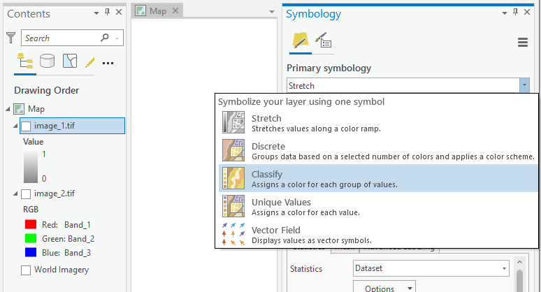

With some images, Primary Symbology > Classify is available in the pick list:

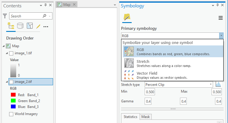

But with other images, Classify isn't available:

It looks like Classify only works for Grayscale images, not color images.
