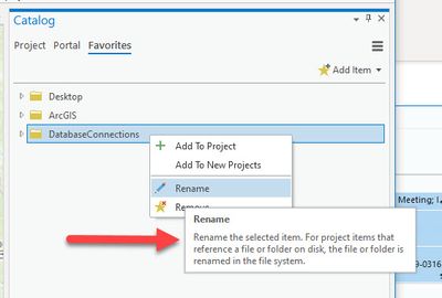

JeffreySchmidt3000
Searching here in March 2021 after in Pro 2.7, I added a folder, renamed it and broke our company for a while… it looks so benign… add a favorite folder and rename it so you know what it is… with really dire consequences if you don’t notice the tooltip and you have the privileges to update network directories… for other windows folders it is disabled… For Documents\ArcGIS is fails…  The Content Pane functions with the flexibility to change titles/aliases without changing sources… I was expecting a “favorite” to behave in the same way.
