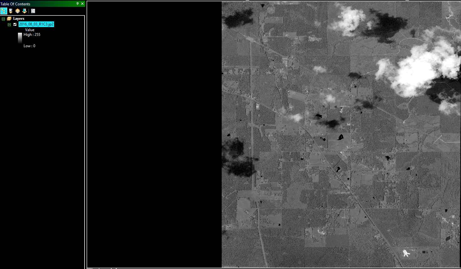

Sorry guys, I got tied up...This is what I see when I Add Data, go to the raster data set and import the 4 raster band files. It's just black and white no color

If the 4 rasters represent 4 different bands of a Multispectral image, you should use Composite Bands—Data Management toolbox | ArcGIS Desktop . This will create a multispectral image.
Just adding the bands to Raster Dataset would create only single-band images since the inputs are single-band images.
*Remember to add the bands (Rasters) in correct order while using Composite Bands Geoprocessing tool.
