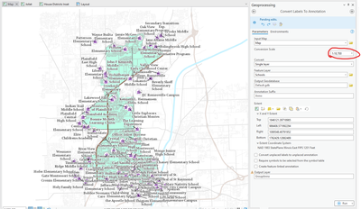

I'm using Pro v. 3.3.2. And what @MattRummel said worked for me too.
Under Unplaced labels, check Never remove and then zoom out to a level where all your labels are showing. If you don't zoom out it only converts the labels in view. Next, in the Convert Labels To Annotation pane set the conversion scale to whatever works best. I set mine to 1:18,700 because that's the 1 to 1 in my map layout.
