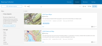

Can you browse to your org's basemap group? Make sure that the web map that basemap is coming from is the current supported version, and that it is shared properly with your org members.

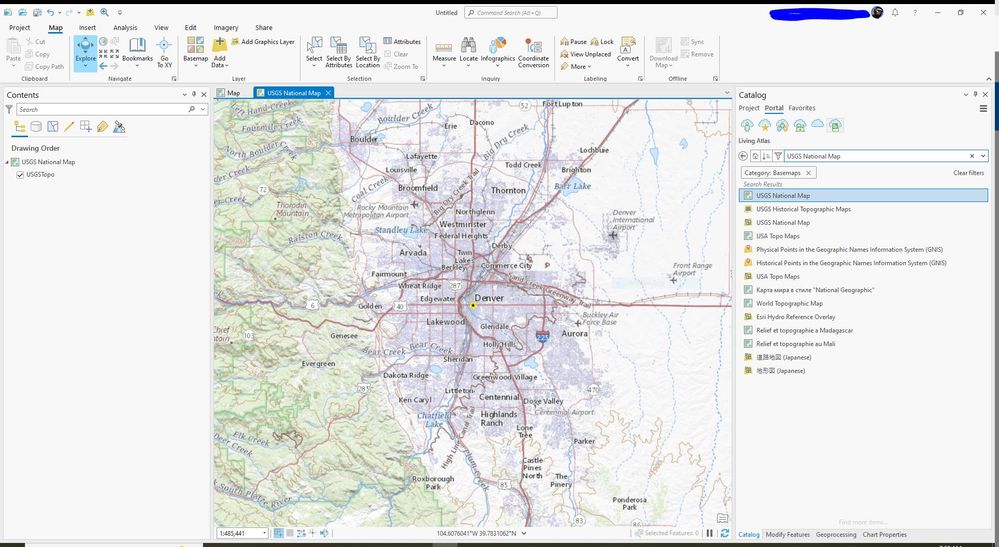

I can add the USGS National Map in ArcGIS Pro without any issues (see attached).  What I did was go to the Catalog Pane->click the far right icon for Living Atlas, filter on Basemaps and search for USGS National Map.  It's a web map.  I right-clicked on it and selected "Add and Open".  It adds to a new Map View in ArcGIS Pro without any issues.  What is your workflow?

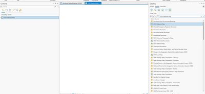

Thanks for your reply. Robert I try your suggestion first to bypass the basemap--but the screenshot show it was blank.
