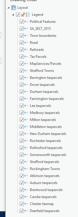

I have made a layout file with the above setting. When I add this layout to my project and set which map the Map Frame should reference - immediately all the layers in that map are added to the Legend. As shown here:
Added layout and legend is empty:

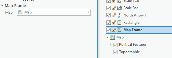

I set the Map frame to reference the Map
And now the legend is full of layers that I DO NOT WANT THERE

The "New layer" option under Synchronize with map refers specifically to new layers added to a map. When you set a new source map fro a map frame you are not changing the layers of an existing map. You are pointing the map frame (and all the map surrounds referencing this map frame) t a new map. Therefore the legend will be repopulated with the layers of the new map just as if you added a new legend to the page. The only difference is the existing legend should keep any legend formatting you have made.
Currently, there is no way to create an "empty" legend where you add the layers you want. Instead, the model we chose is one of subtraction. Turn off or remove legend items you don't want.
I'm assuming that the items (layers) you see in the legend all belong to the map that is now referenced by the map frame. If this is not the case, then there is likely a bug. If so, this is by design.
