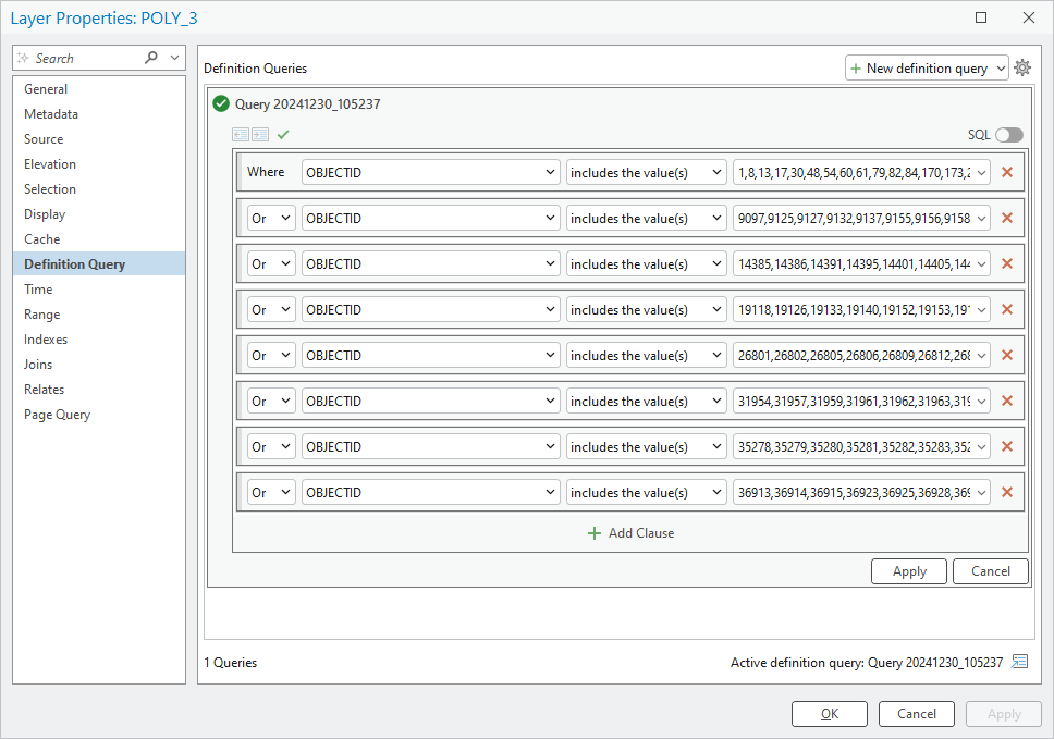

Why are definition query clauses limited to 1,000 values?
865
12-30-2024 08:00 AM
Bud
Esteemed Contributor
Generate Definition Query From Selection
A definition query clause has a limit of 1,000 values. If the selection includes more than 1,000 values, the resulting definition query will include multiple clauses.
I understand that 1,000 values in the IN clause is a lot (and unconventional in terms to SQL best practices). I understand why there might be a limit.
Buy why 1,000? Is it based on a known database limitation for certain kinds of DBs?
