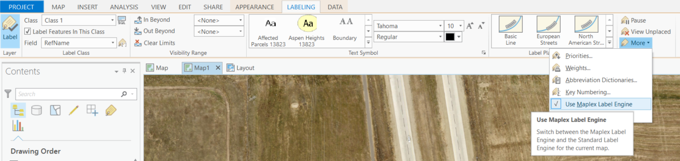

It looks like you need to open up the feature layer ribbon and under it, click on the Labelling ribbon. On the right side, there is a More button and from there you can check on Maplex

Yeah, took me a while to find that as well. Looks like on import of a MXD with existing Maplex labeling, it converts it to standard labeling. I manually updated on of my layers to revert back to the Maplex style I originally had, and WOW, was it slow! I'm used to a performance hit for using Maplex, but the performance hit in Pro is basically "so much it's unusable".
