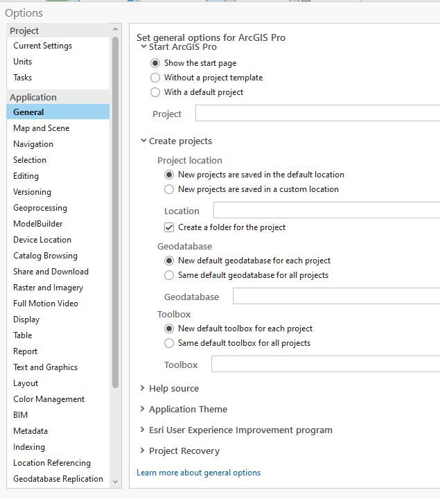

It seems to me that General Options can't possibly be stored in a project, since you can get to this GUI without even opening a project. Does anyone who where this file is, and what it is named? Thanks!
Launch ArcGIS Pro
Click on Settings ("the gear")
Options
General
Then you can set general options for ArcGIS Pro
You never have to touch a project, therefore these settings can't be persisting inside of a project.

I believe they are stored in your local user profile i.e. %appdata% in a 'user.config' file.
PeterWang
AHA !
C:\Users\PeterWang\AppData\Roaming\ESRI\ArcGISPro_StrongName_BLAH_BLAH_BLAH\3.1.0.0\user.config
