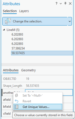

there is one in editing
Edit feature attributes—ArcGIS Pro | Documentation
Type attribute values for new features—ArcGIS Pro | Documentation
Alternatively, right-click the field and choose one of the following commands:
Get Unique Values
I don't remember one for select by attributes
Choose a value currently stored in this field.

JenniferCadkin
The Attributes pane and Editing Templates attribute grids have Get Unique Values functionality.  Right click on the attribute and choose Get Unique Values.  Then click in the cell to access the dropdown.
