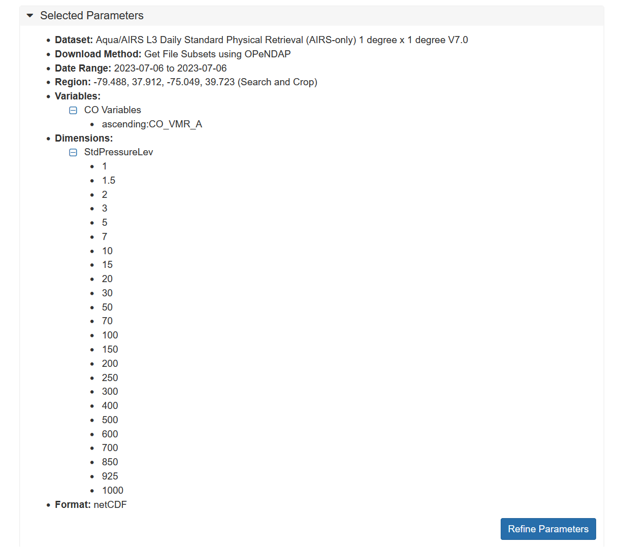

I subsetted and downloaded the dataset with these parameters:

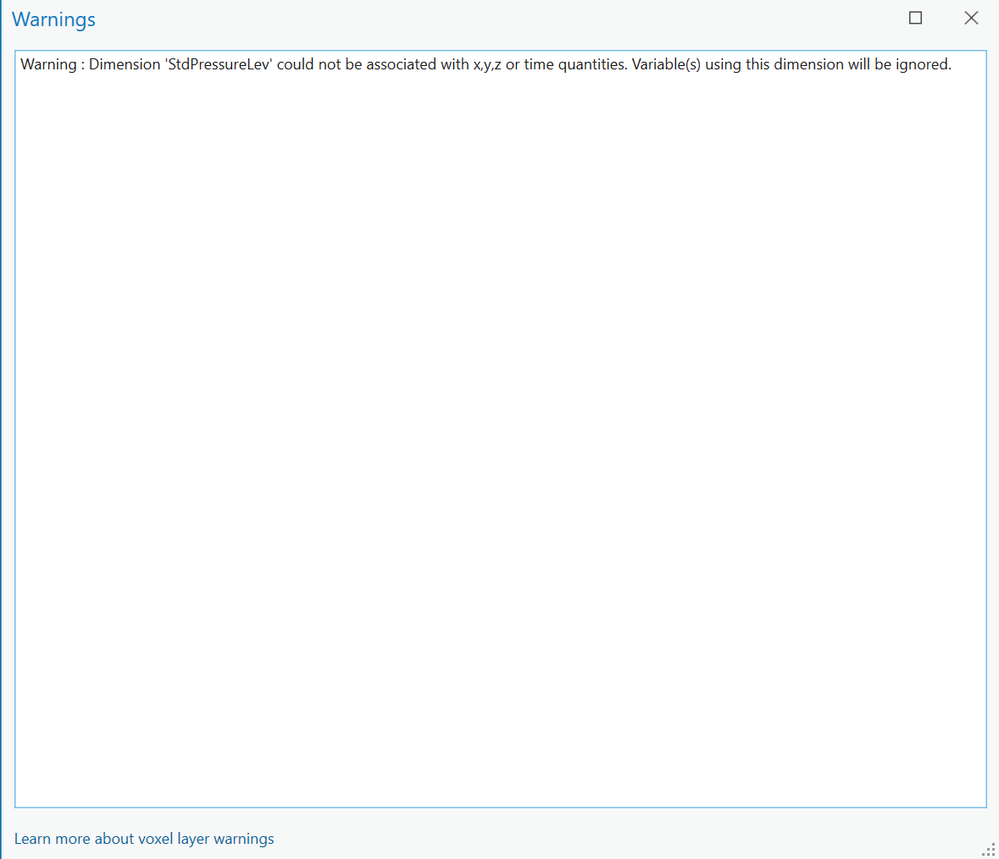

In ArcGIS Pro, I opened Add Data → Multidimensional Voxel Layer and input the single data file I'm working with. However, I got an empty variable list and this warning:
I haven't found anything on the internet about this warning, so I'm not sure how to deal with it.

Based on the screenshot it looks like there is only 1 dimension. In order to render the netCDF file as a voxel layer you need to have X,Y,Z dimensions in the netCDF file as well.
https://pro.arcgis.com/en/pro-app/latest/help/mapping/layer-properties/voxel-layer-freqently-asked-q...

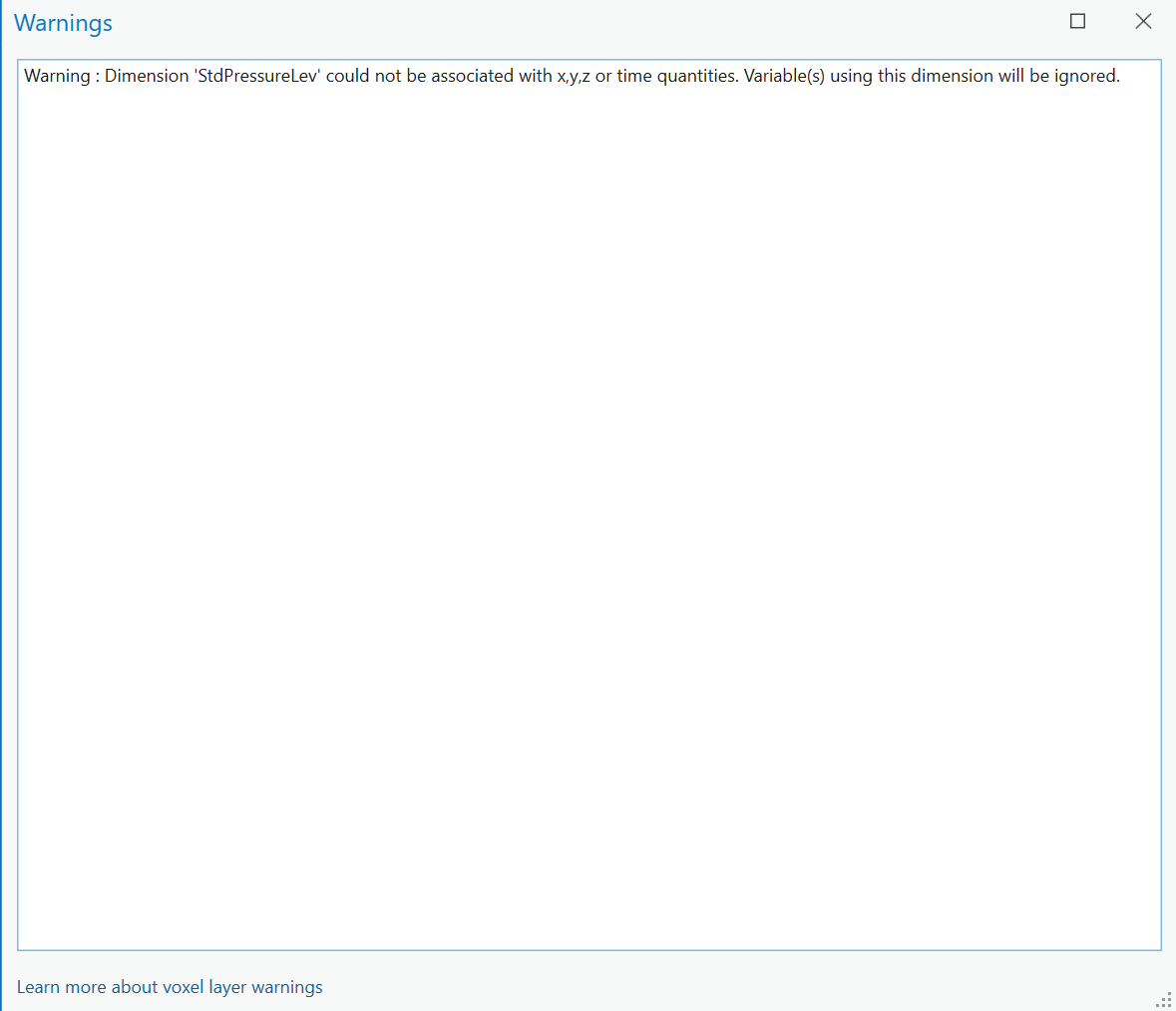

zdgra
Hey Andrew, what does this null here mean?
Andrew--Johnson
Where was this screenshot taken?
