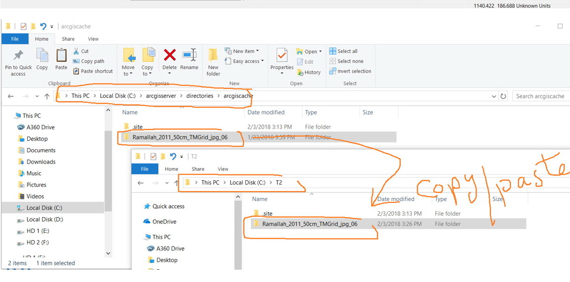

Cached service can be transferred from a machine to another and configured using the ArcMap as follows:
1-The cached service is copied to the target machine

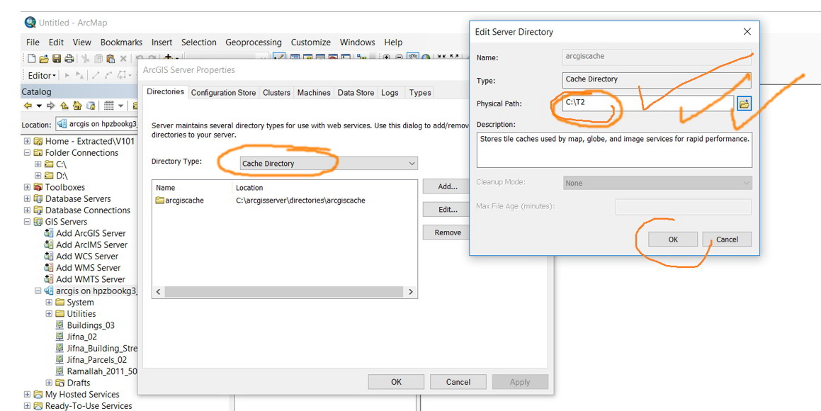

2-The cache folder of the ArcGIS Server is redirected to the folder that contains the cache service

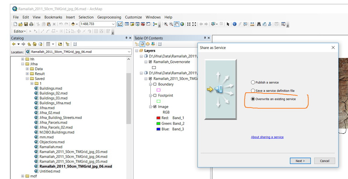

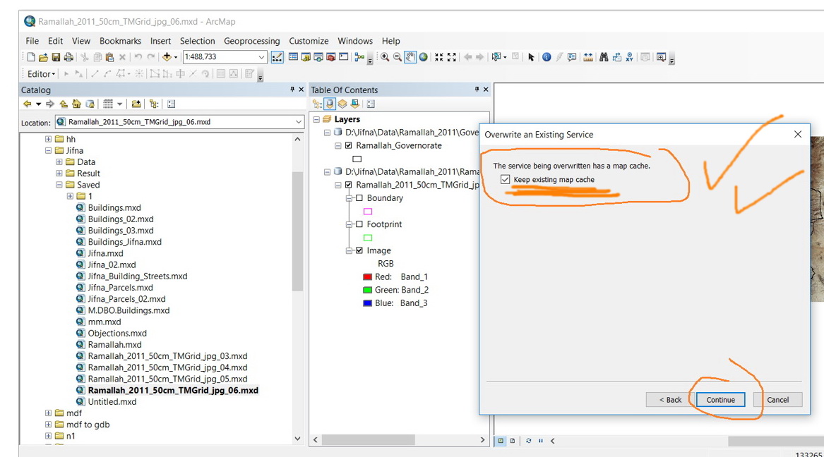

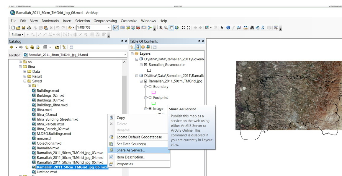

3-The mxd is re-published using the ArcMap with overwritten option checking the “keep existing map cache” option too.
I couldn’t figure out how this can be managed in ArcPro particularly step #3 above.
