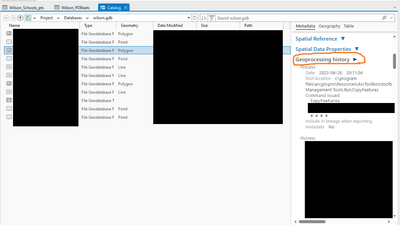

@Bud you can change the Metadata Style to anything except the default Item Description in order to see the geoprocessing history that is stored in the dataset metadata.
https://pro.arcgis.com/en/pro-app/latest/help/metadata/view-and-edit-metadata.htm#ESRI_SECTION1_0FAB...

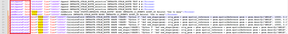

I'm looking for the complete geoprocessing history of a given FC, the equivalent to what I can see in the XML:
That XML geoprocessing history goes all the way back to when the FC was created in ArcMap 9.3.1 (?) in 2011.

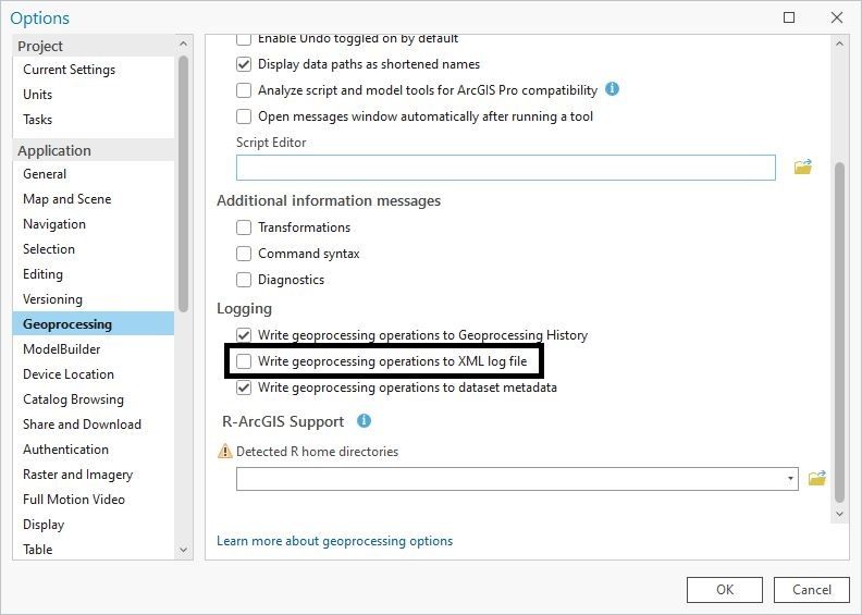

Is this what you're looking to do?  See image below.  Go to the Project tab ->Application->Geoprocessing and check the "Write geoprocessing operations to XML log file"
