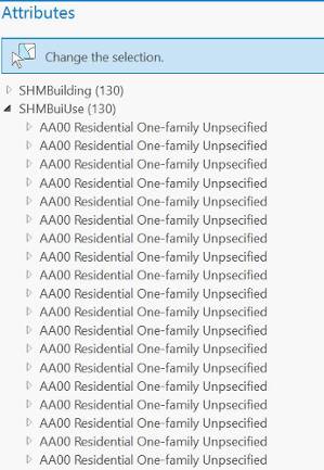

I found a screen image from when I was tinkering around a year ago when trying to find a way to select multiple origin features (buildings) to assign/change to the building use table (SHMBuiUse in image below). Back then I solved it!
In the picture you can see how I selected (130) multiple buildings and how I get all the 130 related building use records below. Next step I just selected all of the related records and could change/set building use in one go.
After the update to 2.5 the related posts (SHMBuiUse) does not show.

Now when you select your buildings, the Attribute pane will show those buildings and their related records. You can edit multiple selected records at once if you click on the root of the selection tree - in your screenshot above, where it says SHMBuiUse (130):

At first it did not work. But after playing around for a while I figured out that stangely enough I had to choose "Remove all relations" and "Remoe all joins" from the layer to make it work like you describe above. Do you understand why?
So now I have a copy of the building layer for enabeling a way to select multipe "Building Use" records. Thats fine, but I really dont understand why it works this way.
