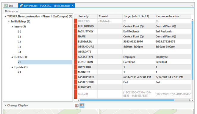

Since upgrading to ArcGIS Pro 3.2.0 the Version Changes / differences view is no longer showing data changes in the "Show conflicts" view. From the documentation here, this is what I should see:

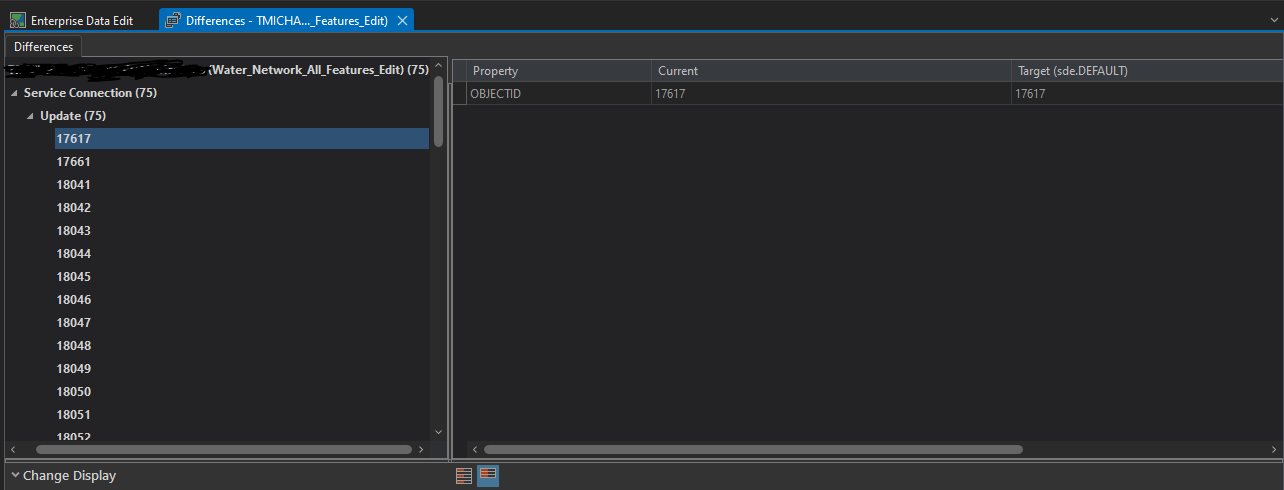

However this is what I see:

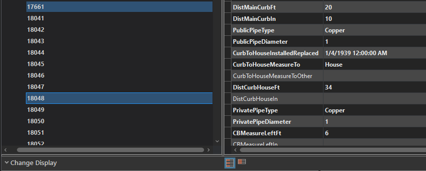

If I switch to the Show All view I can see where new information has been added to the attribute table, but cannot identify attribute values that have changed.
