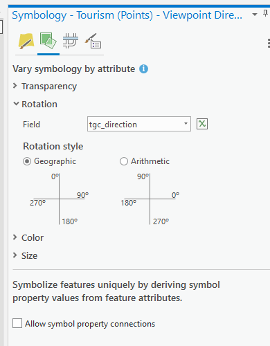

I have a point layer file that I imported from ArcMap into ArcGIS Pro. In ArcMap, the advanced symbol property of "Rotation" was set, and when I inspect the symbology properties in Pro, I see the rotation field properly set in the "Vary symbology by attribute" TAB of the Symbology pane. So far, so good, the layer displays the rotation properly as well, so no issue here.
But at the bottom of the Symbology pane, when "Vary symbology by attribute" is the active pane, there is a checkbox "Allow symbol property connections".
It is not clear to me, what this option does??

This text suggests that for some reason you are supposed to additionally activate the attribute driven symbology by checking this box on. In my case it isn't checked on, but still, the rotation is applied properly??? So what does this option do?

Hi Marco,
Perhaps this is subtle in the introduction of that help you refer to: Attribute-driven symbology—ArcGIS Pro | Documentation
You already have rotation hooked up to a field, so you're all set.  If you needed to further control customization of other specific aspects, you could then enable attribute-driven symbology which would expose control over many other properties that could be driven by attributes.
Does that help?

Hi Kory,
Thanks, yes that helps.
Yes, the text is subtle, and combined with my ignorance of how far reaching these new options are in terms of possible connections between attributes and symbology, I hadn't yet fathomed this, especially since I haven't yet tried out the options as described in the mini-tutorial included in the Help page. That ignorance was cleared up by your screenshot though...
