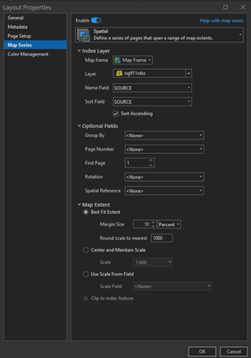

I am trying to use the Strip Map Index Features tool in a model. Unfortunately when doing so, the page size settings reset themselves as shown in the attached screen capture. Currently running ArcGIS Pro 3.1.3. Has anyone else experienced this?

Not sure I understand what you are asking.  Are you experiencing the issue where the settings in the Layout Properties/Map Series/Map Extent do not lock to the scale you set?  If so, a work-around is to add a field and populate it for each feature with the scale, then select Use Scale From Field.

Sorry, all I could see was the image when I first looked at this.  What happens if you un-check the Use Page units and scale?
cdevault_pickett
No worries, it was a GIF that didn't play as I hoped it would. So there was a little delay between first posting and saving my screen capture as a video.
