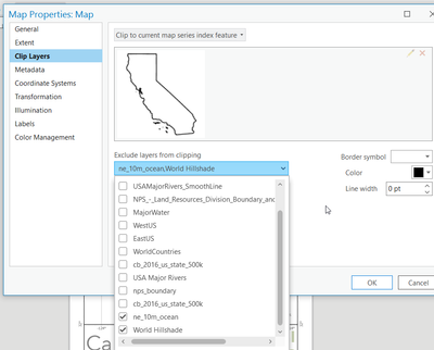

AubriOtis
You can absolutely do this! Map series clipping respects the settings in the clip map options from the map properties. You can exclude any layer from being clipped there. Just select the map, right click and choose Properties to get to the dialog shown below.
I hope this helps!
Cheers,
Aubri

GennyHelt
That worked perfectly!  I had to do the process 2 times. The first time I forgot to turn off the 'copied' layer so the additional features were still present.  User error 😑
