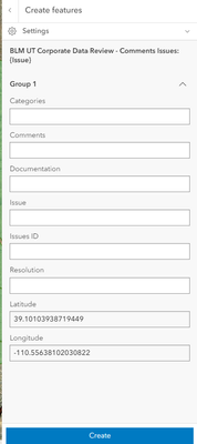

I am not sure why its not working. I just tested it and it worked fine. I also used each individual component(lat) and (Lon) separately in a field calculation using the form builder in the (new) Map Viewer. I created a Latitude Field and a Longitude Field and then applied each section as a field calculation in the form.
