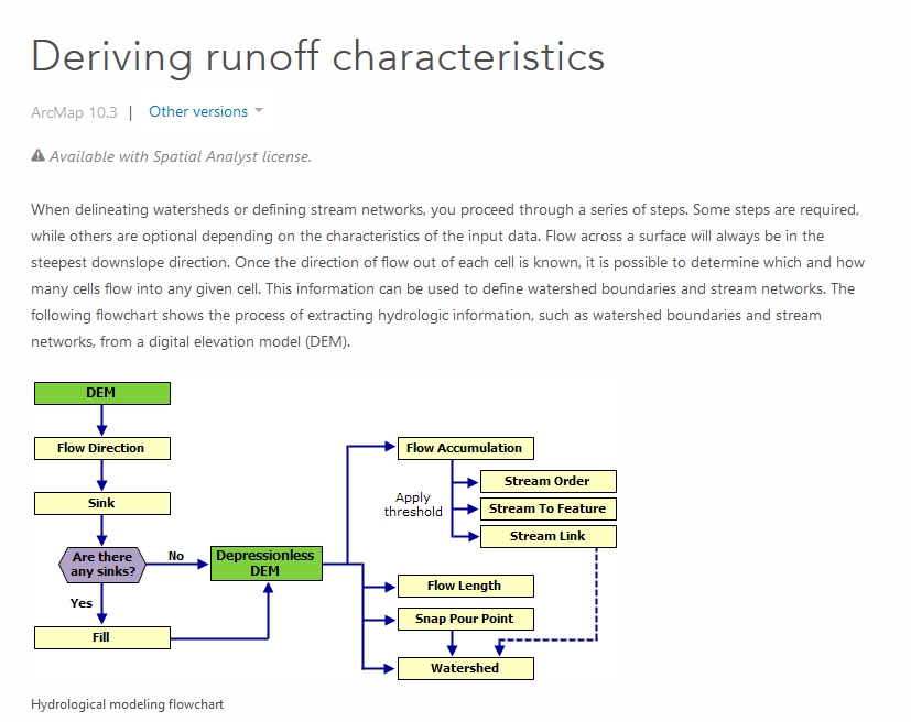

For a start, here's a diagram from an earlier version of ArcGIS Desktop which is helpful in understanding the whole process (I believe the process steps are still the same in ArcGIS Pro).  I am not a floodplain expert, but I have done some modelling, so this may be of help.
Source:  Deriving runoff characteristics—Help | ArcGIS for Desktop
Also, besides the above process, there can be some confounding issues that interfere with outputting a nice neat result.  For example, the Digital Elevation Model (DEM) may not be a fine enough resolution to discern where the streambanks are, or other constraining influences.  Likewise, a bridge may be represented in the DEM as a solid obstruction when in reality there is a location where the water flows below it.  Pipes and diversion ditches may also influence the result, yet not be discerned.
So data cleanup is often a necessary step.  All these unwanted issues need to be identified and then remedied.  One common remedy is to "burn in" the proper morphology into the cells where the DEM misinterrprets the reality.  For example, one could use Raster Calculator to do a subtraction on a cell where a bridge was recorded as a full feature to create the "gap" for the water to pass through.
Also, the settings used in some of the specific tools can affect the outcome.  For example, you results can vary tremendously depending on how the Sink-filling is handled.  Flow Accumulation is another one where the setting chosen (Expression setting) will produce different results depending on what is chosen.
Anyways, I would start with evaluating your process first. Ensure all the needed steps are being done.  Expect to run several iterations as the settings are adjusted to find the most representative outcome.

You need to run Fill Sinks, first.
