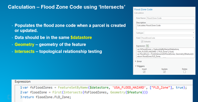

Here is an example of a parcel polygon using the method to find a field value in another layer. In your case you can use the Count method. You might need to combine a SQL query to only select valve that are closed.
