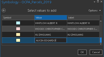

I'm trying to add a specific name, ALICEA EDGARDO, into the unique values symbology.  I type in the name as below:

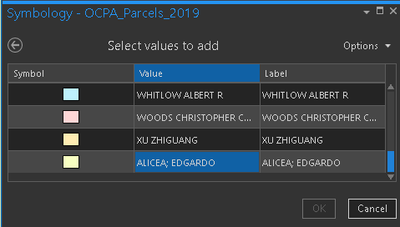

But when I try to commit what I typed in by hitting enter (or tab) it throws in a semicolon, rendering it a value that does not exist in the data.  Why is there a semicolon being add and how can I stop it?  Is the add value window using some particular encoding?

The only place I can find a semi colon anywhere in this attribute field is when Pro adds one as above.  It's like it's trying to make a list with the space translated as a semicolon.
