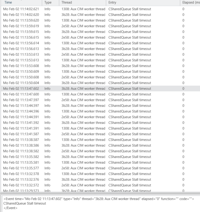

What I see a lot is "CSharedQueue Stall timeout", often several in a row (up to 40 or 50!), which can take up to a minute, combined. Any clues what this is?

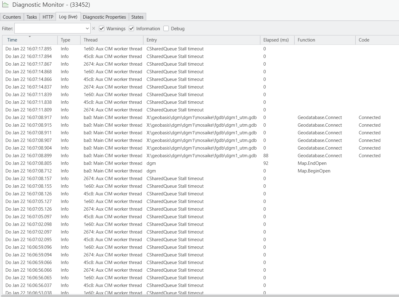

Another thing I noticed is, that AGP often seems to be accessing data that are not in any open map. I have observed this in several projects, actually.
The problem with this is, that some data are on network drives that are painstakingly slow, especially when accessed through our VPN when working from home. E. g. in the screenshot above it is an elevation raster on the X drive. I know that network drives and AGP don't go together well, but that is how my organisation provides our base layers. I have my own data and projects saved locally and avoid tasks that need layers from the network drive when working from home. This approach worked well in the past.

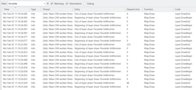

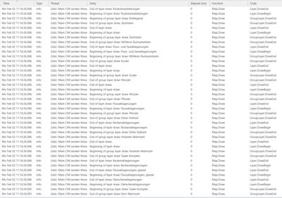

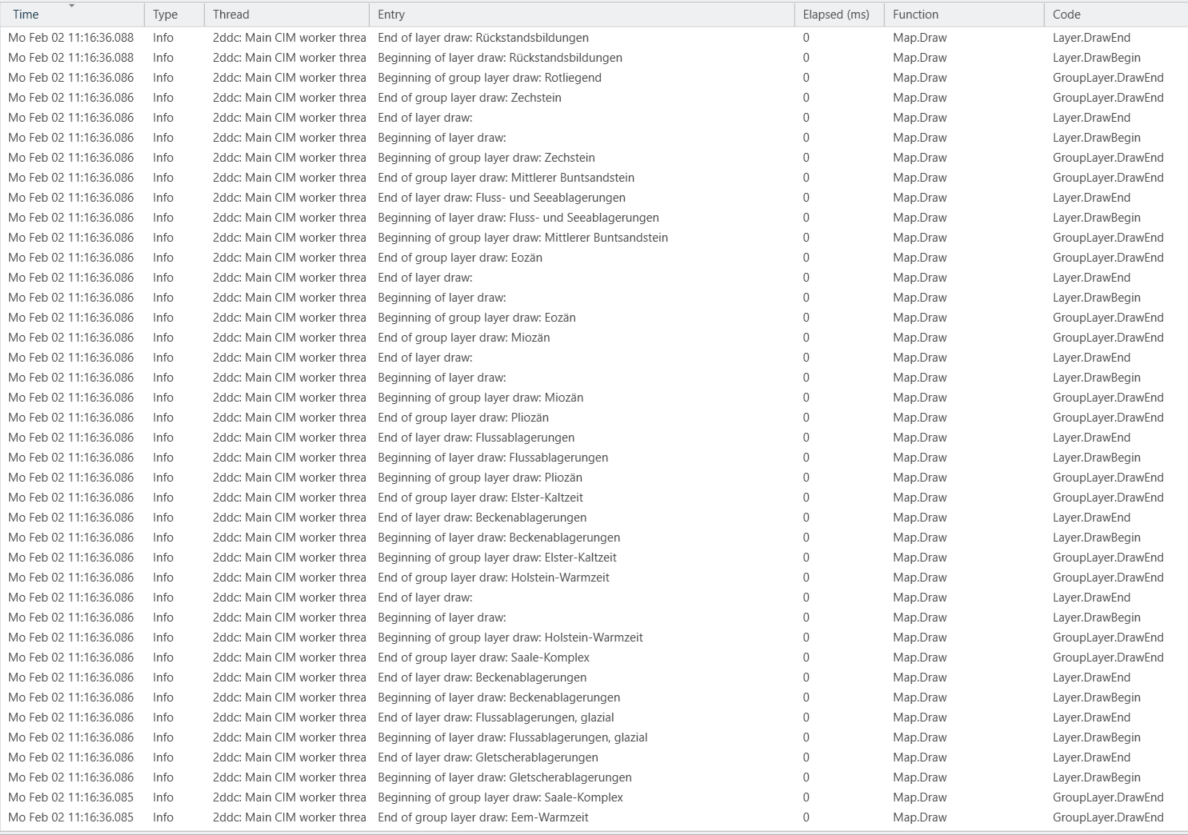

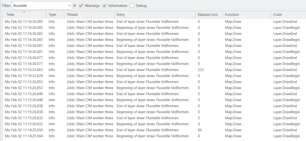

But it seems to go beyond unnecessary data access: Today I was amazed to see the log fill up with entries related to layer drawing, symbol drawing and label drawing. No map was open! Why did AGP draw one – or maybe even several? If I filter for any specific layer I get 10 instances each of Beginning of layer draw and End of layer draw. Did AGP just draw every layer in every map in the project, even though they where closed?

The CSharedQueue Stall Timeout issue in ArcGIS Pro often indicates performance bottlenecks or timeouts during operations, particularly when working with large datasets, cloud storage, or virtual environments. This can result in delays, unresponsiveness, or failed tasks.
I would not consider my own datasets large, but some of the external ones probably are. We don't have virtual environments (I think), but if network drives qualify as cloud storage then that's most likely my bottleneck. Too bad the CSharedQueue Stall Timeout doesn't include more information (what exactly caused the timeout).
