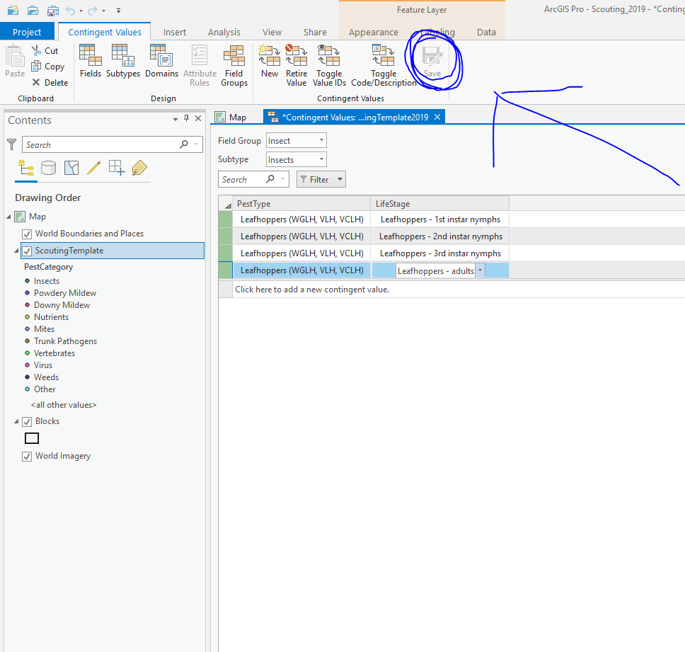

I am trying to create a template for vineyard field data collection in Collector.  For efficiency and data integrity sake, I have defined sub types and domains.  I would also like to assign contingent values.  However, for some reason, ArcPro will not let me do so.
The field save button is not grayed out when I edit fields, subtypes or domains.  I can edit and save in those tabs, no problem.  It also allows me to define the Field Groups and Contingent Values with no error messages.
There is no attribute data currently being edited; the attribute table is empty.
I've restarted the program numerous times with the same result.  The save button is just always greyed out in the contingent values tab, and I am unable to save anything there.
Does anyone know what I am doing wrong?
Thank you so much, any advice is appreciated.

Do you by chance have any unsaved edits in the Map you have open?
EmilyKuhn
No, I don't believe so.  That was the first thing I found in troubleshooting on the topic.  I am not super awesome at Arc Pro yet, but I don't believe I have any unsaved edits anywhere.  To be sure, I exited the program and restarted it.  Upon restarting I ran into the same road block; unable to save Contingent Values.

Did you find any resolution to contingent values not saving - I'm having the same issue.

I wondering if this is a licensing issue - the docs say it is available at all editions of ArcGIS Pro - but I'm wondering if it is in error and only available at standard edition and up.

I have an advanced license so I don't think it comes down to licensing.
I have not been able to resolve this issue.  I gave up and started waiting for Pro 2.4. Maybe it will be fixed...
Plus through my field applications it became apparent that there is still a lot of troubleshooting to be done with subtypes and domains. For myself, I think that using contingent values when they're still so new in the program will only lead to data extraction problems down the line.
