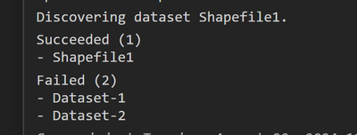

Correct. I structured it exactly like it said and it doesn't detect the parquet files. However, if I add a subfolder containing shapefiles into the source folder, it picks up the shapefiles, but not the parquet files. If I use the actual Create Multifile Feature Connection tool, it says it succeeded with the shapefile, but it failed with the two parquet subfolders. Unfortunately, the tool provides no additional error messages or reasons on why it failed. This is literally all the information it gives me.
