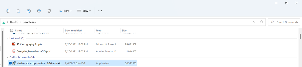

I have installed .NET 6 Desktop Runtime x64, as for the Microsoft Access Database Driver Engine I have installed the X64 version which I've provided screenshots below. I just ran the system requirements for ArcGIS Pro and it checked off for the requirements so I'm really at a loss here
AccessDataBaseEngine_X64Screenshot.pngAccessDataBaseEngine_X64Screenshot.png.NET 6 Desktop Runtime x64.Screenshot.png.NET 6 Desktop Runtime x64.Screenshot.png

Yeah, I would be at a loss too. Another thing that happened to me was that my computer did a major update and my aprx project files would hang after that too. I had to go back in and reinstall those same drivers and things are working again. I am not sure if that would work for you but maybe worth a shot.
