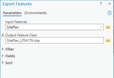

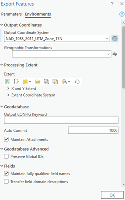

Has anyone else noticed issues exporting data from a file geodatabase to a shapefile in a different coordinate system in ArcGIS Pro 3.3? In our case the data was originally a CAD file converted to a feature class in State Plane, and we needed to export it to a shapefile with UTM coordinates. We normally accomplish that by setting the output coordinate system parameter in the Environments tab of the Export Features dialog.

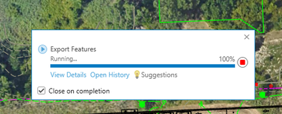

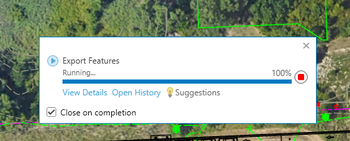

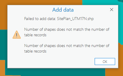

Today, though, the Export Features progress bar shoots right to 100%, and then hangs eternally. Cancelling the export appears to be an equally eternal process and we end up having to terminate Pro from the task manager. Files are produced but they are not usable.
Note that we are able to export the same feature class to SHP from the same project if we don't change the output coordinate system. Everything else is the same.

Thanks for helping! I opened a new project (no template), added the feature class, and exported it to a folder as a shapefile with a new output coordinate system (see screenshots).  This time it has been hanging at 45% instead of 100%, but otherwise the outcome seems to be the same. I eventually cancelled and tried again but with a new filename (the first time I had attempted to overwrite a previous attempt), same outcome. Killed that project and tried one more time, this time attempting to save the shapefile to the C: drive instead of a network drive... same outcome.
