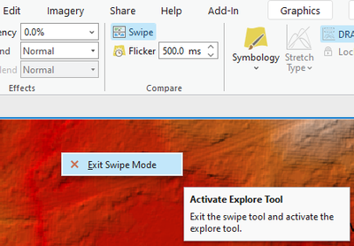

Bud
Esteemed Contributor
Right-click in the map and click Disable Swipe Mode to turn off swiping:
Idea: Disable swipe by unclicking the swipe button
