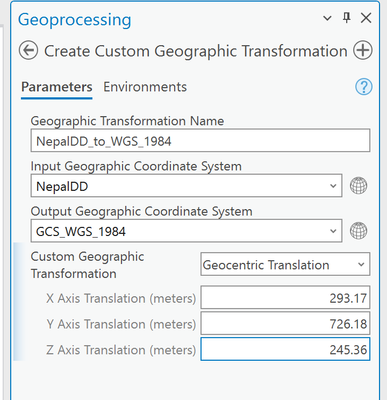

paudelsushil
Hi @PrakashKarki, I have also faced these problems while overlapping the local unit shapefile of Nepal over the OSM layer.
I have the best solution for this problem.
First of all, "Create custom geographic Transformation" using ArcMap or ArcGIS Pro where  you have to choose Geocentric Translation Method  under Geographic transformation methods.
Then, use the parameter values as shown in the figure:
"Project" your ERSRI: 37202 to EPSG:4326 using the above-created Geographic transformation.
You will get a new feature class having EPSG:4326 projection definition.
