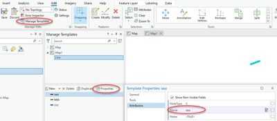

@WDMParkPlanner it seems like you need to inspect your feature templates. The template named "Blue" doesn't have an attribute stored in the template for the "Color" field.
  1. Edit tab > Mange Edits Group > Mange Templates
  2. Select the layer at the top of the pane
  3. Select the template at the bottom of the pane
  4. Click Properties
  5. Within the Template Properties, set your Color to blue.
It also sounds like you are missing a template for red. So create a new template within the Manage templates pane.

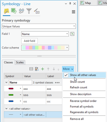

It also seems like you don't have 'Show all other values' checked within the symbology pane:

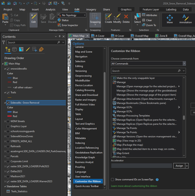

WDMParkPlanner
Scott,
I am so grateful for your insight and reply. I am very eager to try and follow your methods. However, I have hit a snag quite early. I am struggling to find "Manage Templates" anywhere. I've even tried searching the "All commands" for customizing the ribbon and performing a top "Command Search". Any ideas on why I am not able to find that window? I bet it's right under my nose.

@WDMParkPlanner My best guess is you applied your symbology before you had existing "red" features - explaining the corresponding missing "red" feature template. Feature Templates should be autogenerated when you change symbology unless they have been authored by you beforehand. If you find a pattern that doesn't make sense, let us know. Esri Support is a good starting point as well.

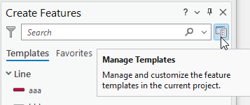

Scott_Harris
@WDMParkPlanner In older releases of Pro it's available from the launcher and using this button at the top right of the Create Features pane:
or
