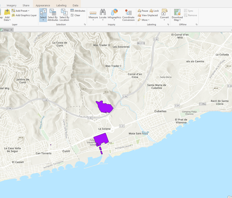

The published service is composed of a set of polygons overlapping each other (each of the polygons has different attributes).
I've generated a simple symbology in ArcGis Pro, classifying by a field.
ArcGis ProArcGis Pro

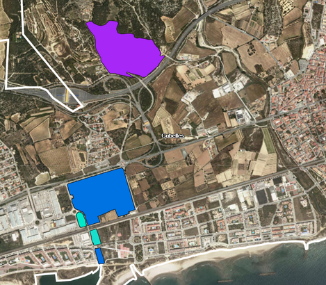

When publishing the service in ArcGis Online I see that the color of the symbology changes and I would not like that to happen.
Agol MapViewerAgol MapViewer
Can you think of any way to solve it? Thanks

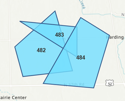

Ah, that explains it. Symbol layer drawing does not carry over to AGOL symbology. What I meant is that when symbols overlap, the system has to determine which one renders "on top". In AGOL, it's in ObjectID descending order
Consider the following features with their ObjectID as a label:
Regardless of other symbology settings I apply, the higher ObjectID will be "on top".

DanielPérez_López
The symbology simply paints the polygons according to the value of a field (Fincas Industriales en Uso: Distribución; Fincas Industriales en Uso: Generacion...).
They all look the same because in Pro, effectively I have activated the option "Enable symbol layer drawing" which is how I would like it to look in ArcGis Online because I have defined the hierarchy of the symbology.
Yes, in each of the geometries that I show in the image there are 4 or 5 polygons with the same surface, but different field value that is what I want to reflect in ArcGis Online and I can not show it.

jcarlson
MVP Esteemed Contributor
