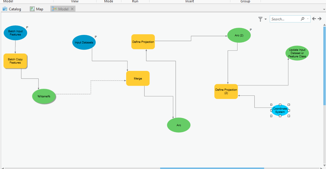

I’m looking for the best practice to convert the Revit files to multipatches and then publish them to AGOL, I need to read the whole data set from Revit file (Architecture, Electrical, Mechanical, Piping, Structural) and to have only five multipatches for the previous categories.
I started with the following model but it’s not generic and it’s only cover the feature in the Architectures elements.
Any ideas?

Hi I could create a model to do this. see below.
