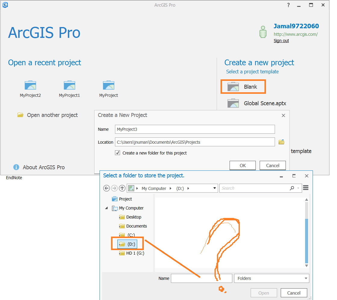

I couldn’t figure out why the ArcGIS Pro fails to create “Project” in the “Root” partition of Hard Drive. I have previously reported that the ArcGIS Pro also fails to connect to this “Root”.
Why might be the issue here?

Hi Jamal,
This is a security setting included by default with ArcGIS Pro.  I would assume this is to mitigate unauthorized access to the root folder of your system.
From the help page:
ArcGIS Pro does not support adding folder connections to the project that access the root node of any disk, for example, C:\ or D:\

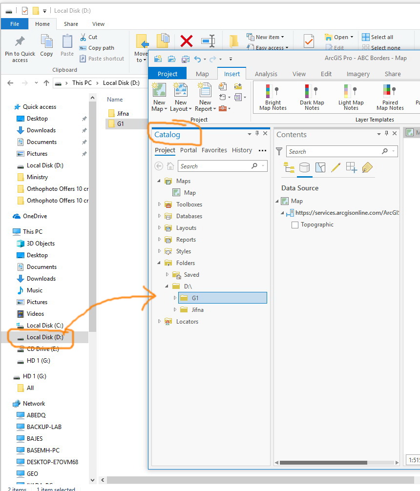

This is already implemented in 2.3 by drag\drop the D:\ drive into Catalog
