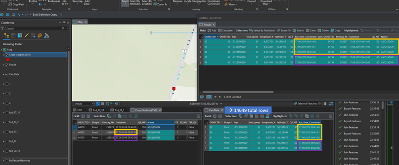

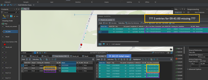

I am trying to connect a car-data-feature (point, speed, ...) to data of changing digital traffic signs on a motorway (e. g. changing speed limits). The motorway data is in 1-minute intervalls (instant-time field) and the car-data in "random" instant time stamps. I want to connect the "matching times" via "Near after 59 seconds" and a matching cross section field in both data sets.
Now it occured to me that when the car-dataset is larger the results are not correct anymore, even when the "extra data" is not even used in the join-operation. This should be explained with the following pictures (they are also attached if it is impossible to read because of poor quality):
expected correct resultexpected correct resultunwanted wrong resultunwanted wrong result
If I am not missing something, I just did exactly the same in both cases, just with different datasets.

Great question. I don't believe this is related to the size of the dataset. The `NearAfter` relationship is exclusive in that it does not include records that have the exact same timestamp. If your layer's time definition is set to use the "Datetime" field, then the results are expected.
One issue I see is that the "Datetime" field appears to have dropped the seconds and is truncated to minutes. This will give you trouble when using a near duration of 59 seconds.
To achieve the results you want, I think you'll need to do the following:
  • Fix the datetime field so that it includes seconds
  • Use the temporal "Near" relation with an extra join condition (in advanced options) that removes everything before. Something like "StartTime($join) >= StartTime($target)" should work.

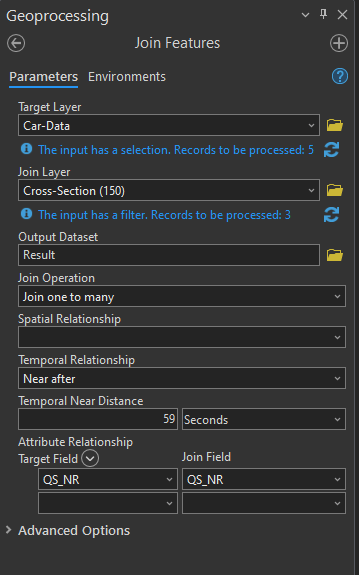

I changed the parameters to "Near" and your Join condition (but for me with a <= instead of >=) and for the data snippet it worked. But I didn't do anything to the datetime field, as I don't really know how I should fix it so it includes seconds. I thought there was no way for it to not include seconds. Or do you mean changing the number format in the field definitions?
I will now try that out with the whole data and mark your answer as a solution when I am sure that worked as well (it will probably).
Edit: Also maybe, while we are at it: Do you happen how to be sure to clear all filters? The Join features dialog always shows me that my inputs have a filter, but I did not set a definition query, have no time or visible-extent filters active or have only some records selected and the number that shows for "records to be processed" seems to be the number of all records anyway.
Edit2: I get it now, it is because if you activate time for the layer it sets a time extent. And Join features interprets that as a filter, even if it includes the whole (calculated) time span and all the data.
