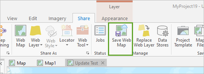

Whenever you want to push changes from ArcGIS Pro to ArcGIS Online, go to the Share tab on the ribbon. In the Manage group, click Save Web Map.

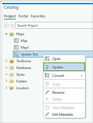

Whenever you want to pull changes from ArcGIS Online to ArcGIS Pro, go to the Catalog pane > Project tab > Maps folder. Right-click on the web map and choose Update.
The link icon on the map icon tells you that it's a link to a web map, instead of one stored locally in the project.
