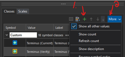

Additionally, you're going to have to add it to the symbology definition.  I can tell by the spacing between the options in the Contents pane that you do not have "Show other values" checked in the symbology definition.  That means any pipe has a value other than one of those 5 is just going to disappear from your map.
You have two options:
  1. Add an item to the symbology for whatever "E" represents.
  2. Enable "Show Other Values" in the Symbology definition.  Then, any value you put that isn't Private, 3-years, 2-years, 1-year, or 6-months will show up as that "other" value.
Personally, I'd recommend both, in most cases.  The reasons to do just one or the other are generally more niche.
To do that, open the Symbology pane.  There are several ways to do this, but one simple one is to right-click on PipeMaintSched, and choose "Symbology".
For Option 1, click the green plus sign (+) to add a value.
For Option 2, click the dropdown arrow next to "More", and then click "Show all other values".  You'll get a new row at the end of the list that covers every potential case that's not in the list.

So, we still need to add the value for "E".  Have you tried clicking on the "+" sign in your symbology pane?  That allows you to add more values that are missing from your unique symbols.  It should show you the "E" value.  Click on the "E" value and then OK to add it to your symbology unique values.
