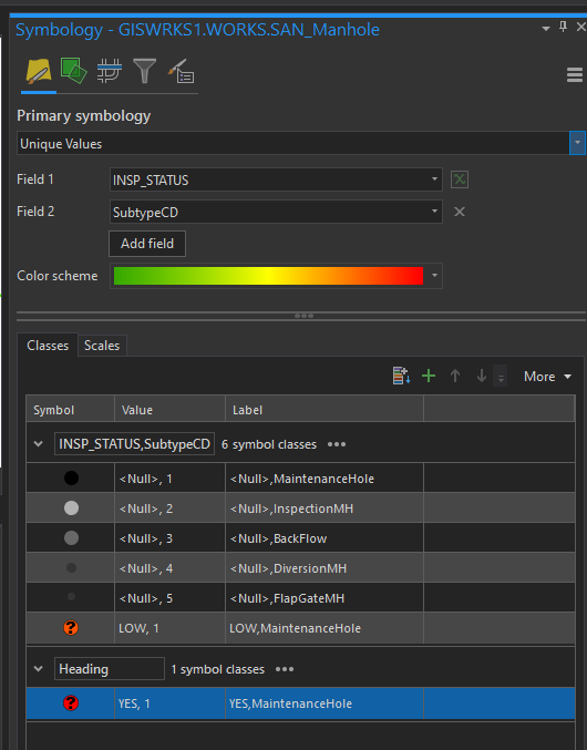

So I need to symbolize based on two attributes:  the INSP_STATUS and the Subtype.  If there is no INSP_STATUS (ie. = null), than each subtype will have a different symbol.
But....if there is an INSP_STATUS (ie. a few different options), than regardless of the Subtype, they can all be the same symbol.  This is what I have so far....a symbol for each subtype:
When I try to add a custom value with some conditional statement for the "YES" INSP_STATUS to cover all of the sybytpes, I just get an error:
Does anyone know how to accomplish this??  Or do I just need to make a symbol for every possible combination of INSP_STATUS and Subtype??

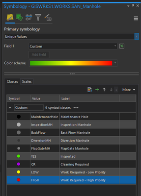

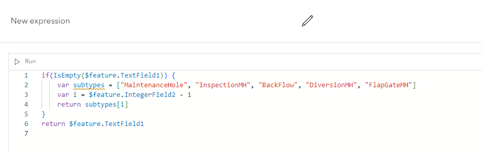

Here is the final product.  It's working nicely!
// for features without INSP_STATUS, return the subtype
if(IsEmpty($feature.INSP_STATUS)) {
    var subtypes = ["MaintenanceHole", "InspectionMH", "BackFlow", "DiversionMH", "FlapGateMH"]
    var i = $feature.SubtypeCD - 1
    return subtypes[i]
// for features with INSP_STATUS = YES
if ($feature.INSP_STATUS == "YES")
    return "YES"
// for features with INSP_STATUS = WR LOW
if ($feature.INSP_STATUS == "LOW")
    return "LOW"
// for features with INSP_STATUS = WR HIGH
if ($feature.INSP_STATUS == "HIGH")
    return "HIGH"
// for features with INSP_STATUS = CR
if ($feature.INSP_STATUS == "CR")
    return "CR"

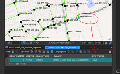

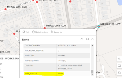

Hi @JohannesLindner .  So I think I see why my symbology in AGOL isn't working, but I can't really explain why.  So, it looks like when I share my data as a weblayer out of ArcGIS Pro, the INSP_STATUS field on the data is getting upated.  I do have Attribute Rules on the related table that has the inspections information.  Do you think for some reason that is getting triggered when I share the data?  Otherwise, I don't understand how that INSP_STATUS field is getting populated.
In my Attribute Rule, I have it set to update the INSP_STATUS in the parent records field whenever a new inspection record is created/updated.  For some reason, I am seeing all records in the published hosted feature layer with that attribute populated.
Here is ArcGIS Pro:
And then the same feature in AGOL:
