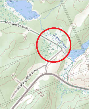

I have a wetland polygon FGDB FC in ArcGIS Pro 3.0.2.
I want to symbolize the polygons as wetland plant symbols (no solid fill).
Like this:
(source: Land Information Ontario topographic tiles -- in provincial web maps like CLUPA)
How can I use or create a symbol like that?

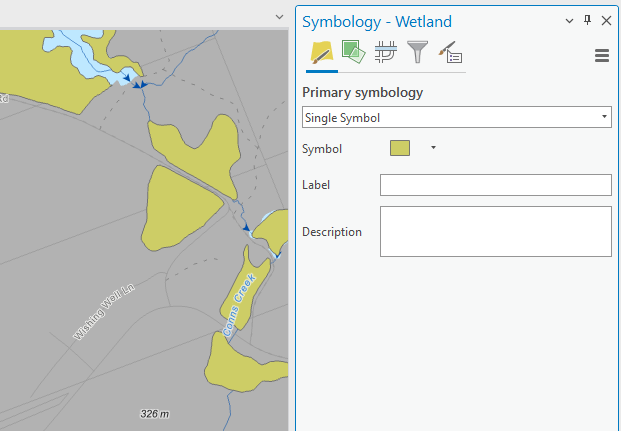

I'm new to symbology in ArcGIS Pro. For other layers, I've seen a Gallery tab. But I don't see that option for this layer.

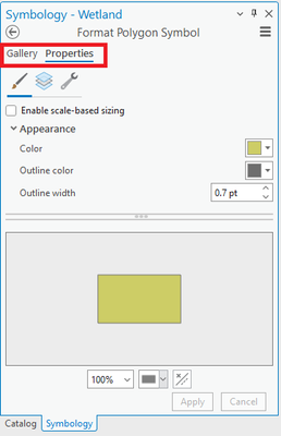

Bud
Esteemed Contributor
How do I get from this window...
...to this window?

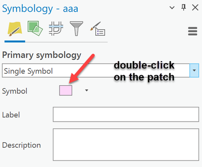

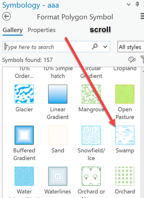

DanPatterson
MVP Esteemed Contributor
The way I do it (one of others I am sure)
