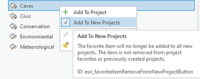

At ArcGIS Pro 2.6, custom styles (which would include any style imported from ArcMap) can be added to project favorites.
See https://pro.arcgis.com/en/pro-app/2.6/help/projects/project-favorites.htm
This means that they can be managed like other Favorites - you can decide whether you want a style to be added to all new projects, or just have it available as a favorite that can be added to projects and used as needed.
Are you already saving your converted ArcMap styles as Favorites and marking them as 'Add To New Projects'?
