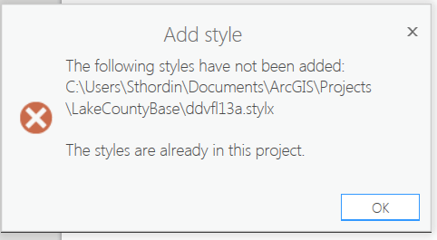

Hi! I just got upgraded to ArcPro and am experiencing some growing pains. I had a set .style connected to ArcMap that included all of Florida DOT's official road signs. I want to add that style to ArcPro and have followed these instructions to import it. It seems to go through without a hitch, but after importing I still don't see the option to use that stylx anywhere. In the symbology/character properties, the style does not appear. When I try to work around and add the stylx from the project folder (styles>add style) it tells me I already have the style added.

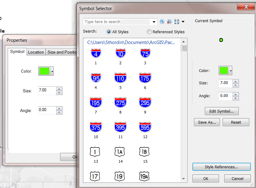

This makes sense, since I already "imported" and it should add to the project automatically, but HOW do I get the stylx to come up as an option in my symbology/character properties??? In ArcMap, I usually do this. Layout View>Drawing Toolbar>Draw Marker>Right click marker properties>Symbol selector>Choose from my connected style folder (see below)
This style does not appear anywhere in ArcPro when I add a marker in Layout. I only have the options of ESRI markers. I know I can create essentially the same markers by editing the basic ESRI marker and adding text on top, it's just in the long run I would really like to have this set up. For clarity, I have been working with the below features in Pro:
