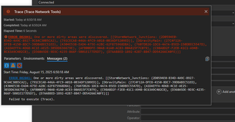

Hi all, i keep encountering this error in the trace network and was wondering what steps are needed to work around it? Some of those fields have subtypes that are empty so I was wondering if that could be the issue.

Would it be possible to create a script to clean these dirty areas prior to the run of the trace network? I'm seeing this related error here: https://pro.arcgis.com/en/pro-app/3.4/tool-reference/tool-errors-and-warnings/001001-010000/tool-err...

It's just weird since the dirty error message mainly targets the stormwater junctions, which were part of the trace network in the specification for creating it.
