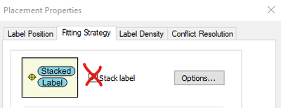

The Stack parameters under the Fitting Strategy option are set to a max of 3 lines, minimum of 1 character and maximum of 24 characters.

try & vbnewline & to make your stack. Do not check stacking in the label properties.
Thanks Sean, but that seems to make no difference at the moment.

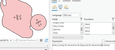

As follows:
[Sub_Comp] & vbnewline & [Species] & vbnewline & [Area]
also tried the more modern & vbCrLf& code too. Output shown below: initial character ('c' or 'b') should be on a separate line.

I can't reproduce this with version 2.9.1. Are you able to share a map package with sample data to review all the settings you're using?
