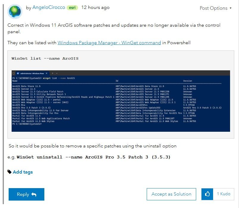

Confirmed as a BUG in ArcGIS Pro 3.6.2 with Esri Support Services.  I do not have a BUG number as of yet but will share it when I know.  A workaround is to uninstall 3.6.2 in favor of 3.6.1 as it's not seen there.  If you're a Windows 11 user, this is the workflow (below) to uninstall 3.6.2.
