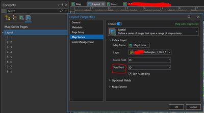

Have you tried utilizing the Sort option in the Map Series properties?
Or is this a different situation?

I recognize that I can sort the Map Series page list, but what I want to do is sort the values displayed in a Dynamic Text box that change based on which page is viewed. The Dynamic Text box links to polygons that are visible within each Map Series page, but I can't find a way to sort them (in this case, I'd like to sort the numerical values from smallest to largest). I've attached a screen capture which shows that the numbers in the box are not in numerical order.
